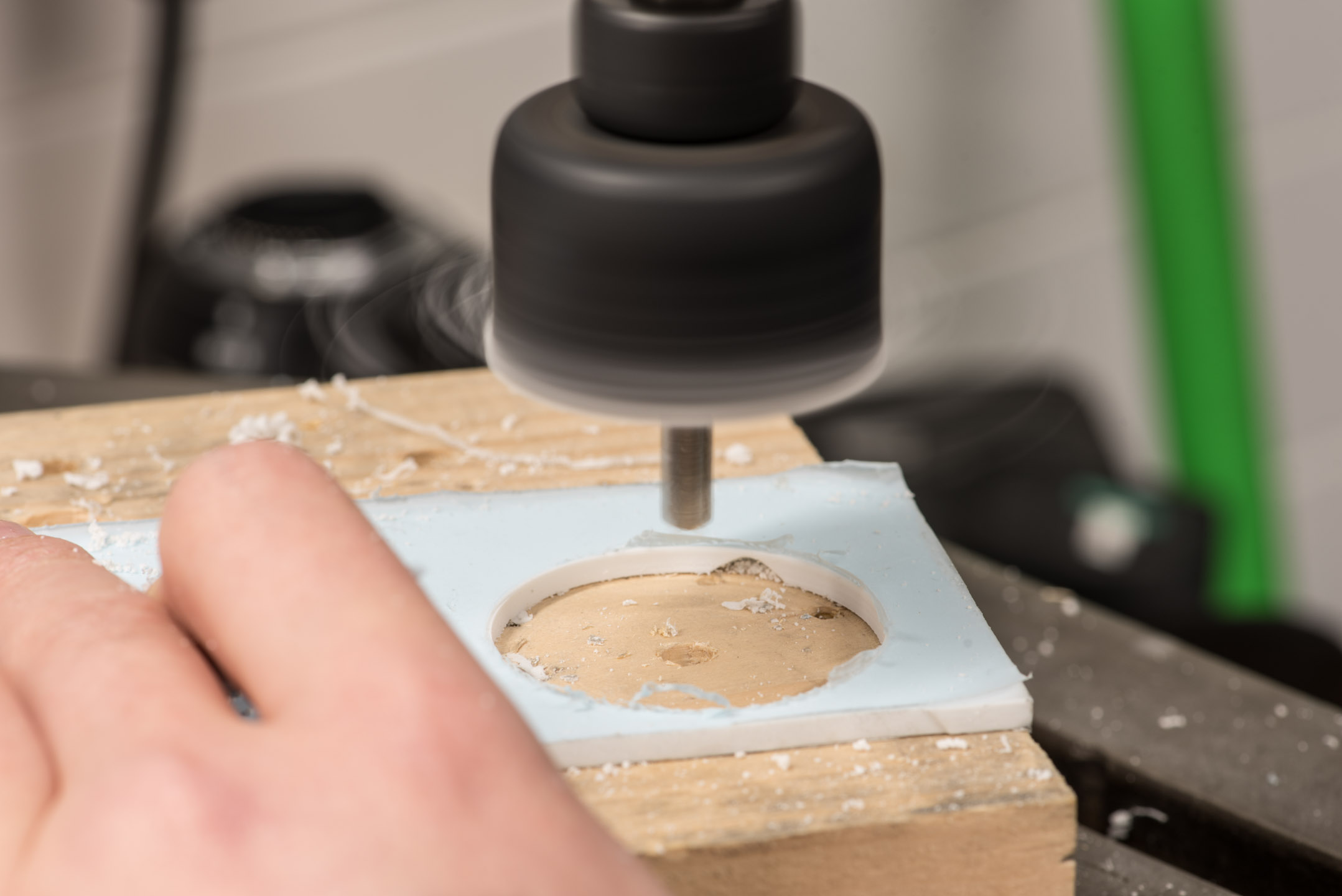

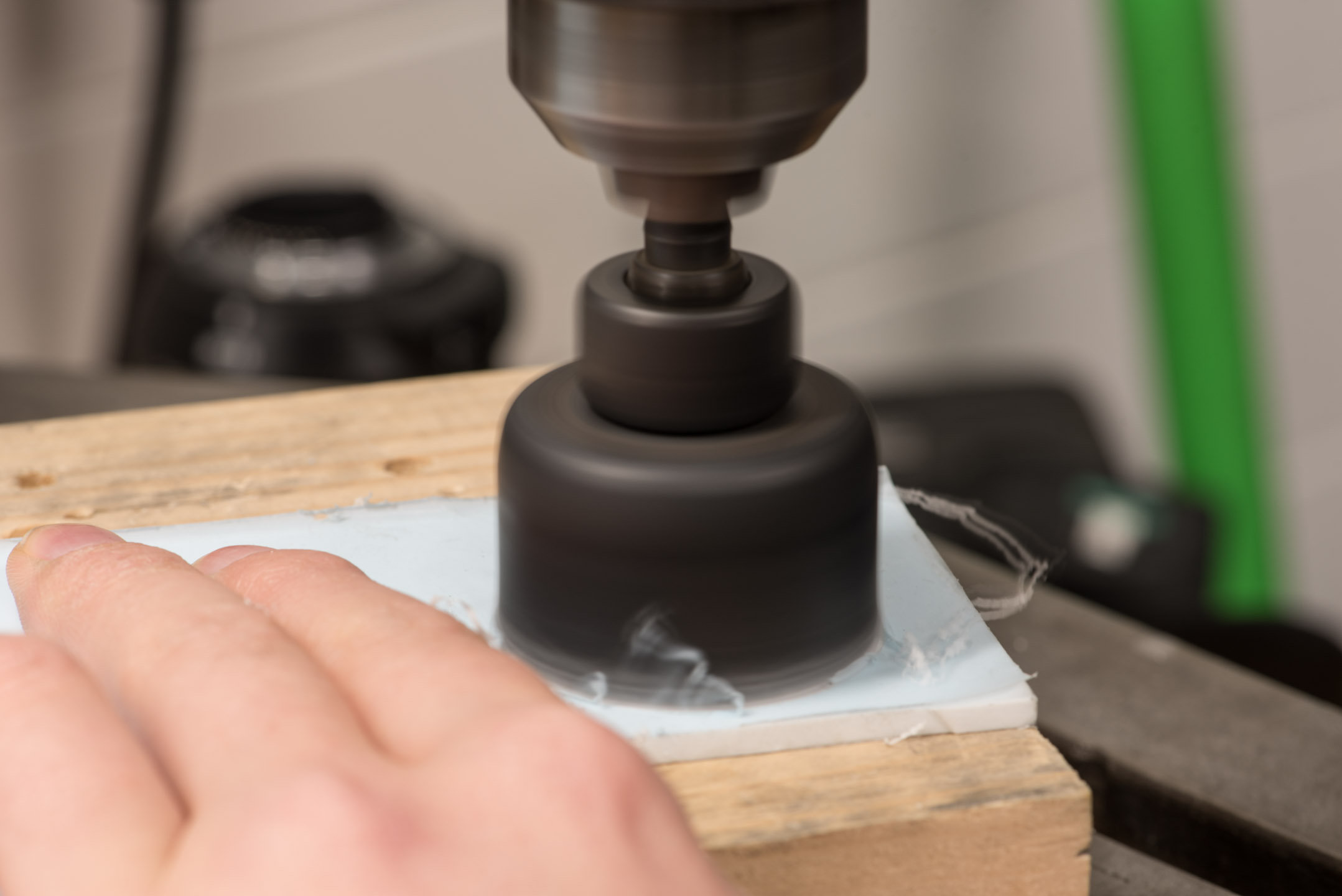

Like stepped drills, hole saws are pretty ferocious looking. Like their name suggests they're for cutting large holes, albeit in softer materials like wood or plastics. They're essentially a serrated collar that fits onto a standard sized drill bit in the centre: As the centre bit drills so does the collar cut.
Cutting into 5mm acrylic
The results are good, this scrap already had nicks
The main advantage with hole saws is size. They can get rather large indeed, and they're a popular method for cutting 120mm holes for fans in materials like MDF or acrylic. That said, they have serious limitations also thanks to their design. You can all but say goodbye to using them on metal, whilst it is possible I simply don't recommend it, as there are better methods out there.
